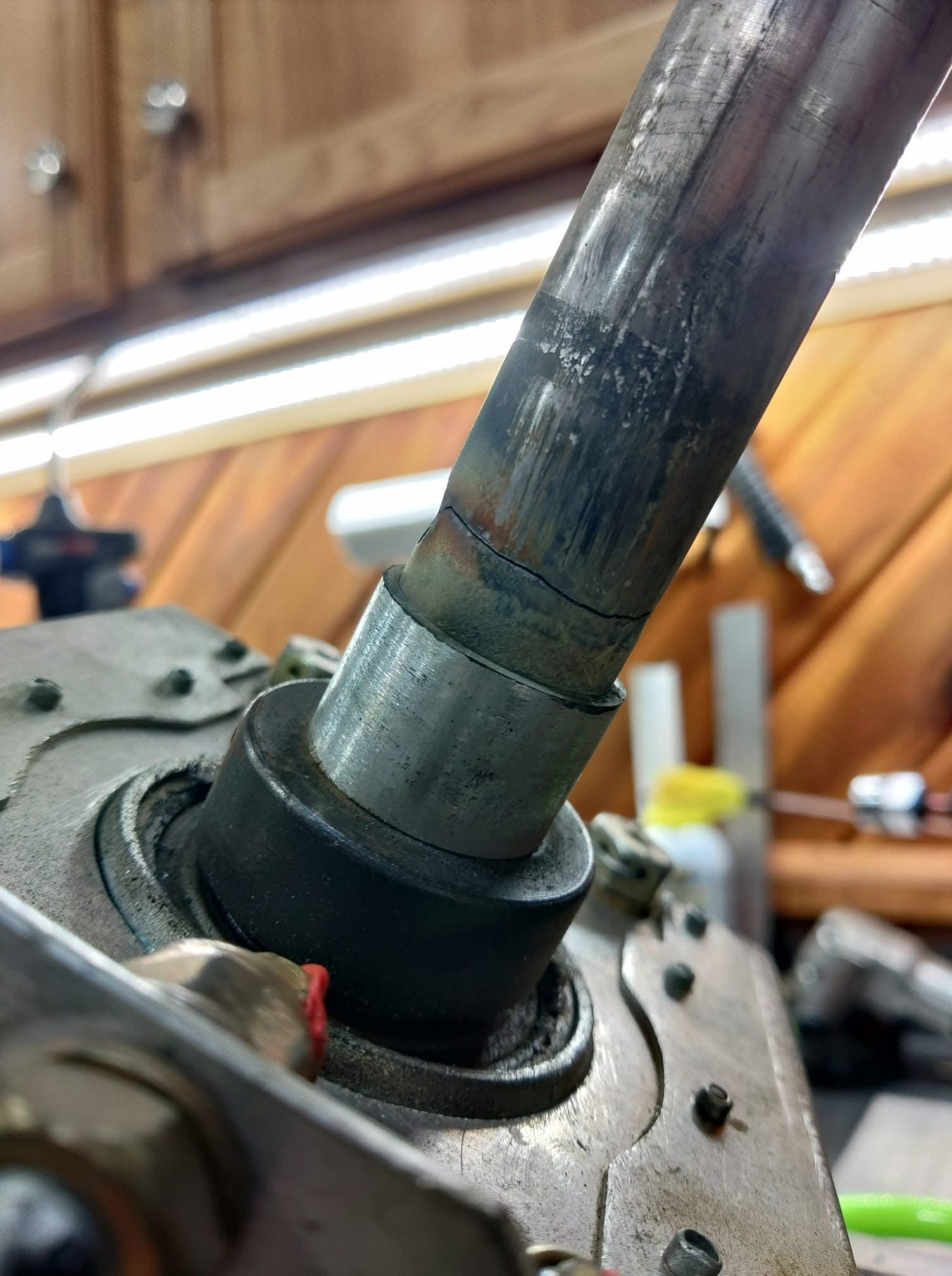

We made our radio calls and made our approach to the taxiway and set down at Torrance. As we rolled the throttle back to idle to talk, I heard a distinctive tic.tick.tic from the tail rotor area of the helicopter. I told my student to shut the engine down as I got out to investigate the origin of the ticking noise. As I was standing next to the winding down tail rotor it suddenly wobbled dramatically and the entire tail rotor assembly from the pulley outward fell off and was just hanging by the anti-torque cable.
Had that happened anywhere else in our flight we would have been in real trouble, God had protected us to have it happen once we were safe on the ground. In the hangar we pulled the remaining portion of the tail rotor shaft out and found that someone had previously drilled a second set of holes in the tail rotor shaft for the tail rotor pulley bolt. The tail rotor shaft now had four holes instead of the two for the pulley bolt.
The two bolt holes that were not being used by the bolt were oblong from an obvious sudden stop like a tail rotor strike. A crack had propagated unseen under the pulley and traveled the weakest route, from hole to hole until the shaft just broke free. Finding this we called the Rotorway factory and inquired about any tail rotor parts sold to the previous owner. They confirmed that they had recently shipped a new set of tail rotor blades and pitch pins to the previous owner due to a ground strike which destroyed both tail rotor blades and bent the pitch pins on both blades.
The previous owner had replaced the blades and pitch pins, had seen the oblong holes in the shaft for pulley mount bolt, and had elected to just drill new holes and not use the oblong holes. The tail rotor strike was severe enough to bend the pitch pins and that force was severe enough to deform the pulley bolt holes so obviously the tail rotor shaft should also have been replaced, but it was not.
The previous owner made no entry in the log book regarding replacing the tail rotor blades and pitch pins so we did not have any warning to look further until the shaft failed on us. I feel so blessed that this happened when sitting on the ground. Had the fog not caused us to make the decision to turn around and return to Torrance, it could have been a very different story to tell if I was still alive to tell it.Many years ago I was hired to provide flight instruction in an Exec 90 at the Torrance, CA airport. This is the same airport where the Robinson factory is located. As you can imagine, this is a very busy airport with lots of R22 and R44 test flights being conducted on new aircraft prior to delivery.

Daniel Meisner posted this photo of what he found on a tail rotor shaft after removing the pulley.
